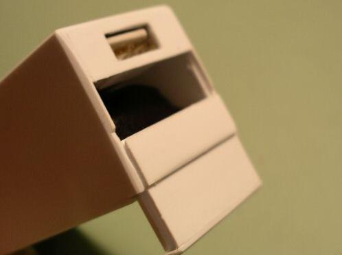

sliding door
/data/files/oldpubfiles/_forum/4182212676608634.jpg
to close off the battery compartment, i made a pretty simple sliding door. it’s just two pieces of styrene with a third smaller piece sandwiched in between. this slides on rails which were made by cementing thin strips of styrene to the case.
